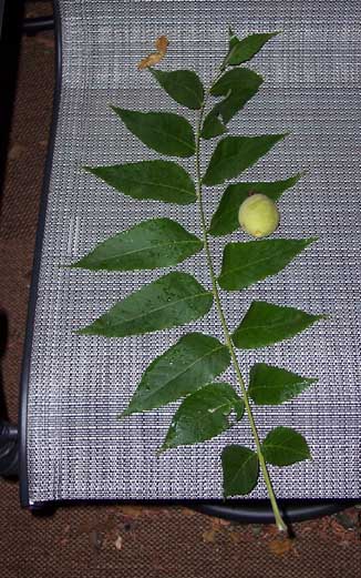

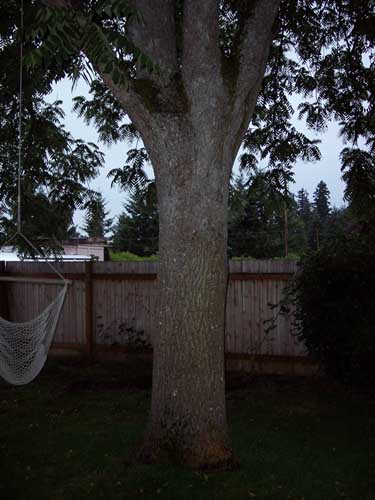

Hey all, I tried to do some homework on the species of this tree but still want to ask you guys. Is this a black walnut tree? It's in my back yard and is about 24" in diameter. We have been wanting to cut this back because it is quite large and goes a good deal into the neighbor's yard.
My question is whether or not you can use limbs for things like bindings or rosettes and end grafts. Some of the limbs are 18" diameter or so... not small. Also, how wide is a typical sap line and do these go into limbs as well?

My guess is Walnut . It will have a mediciney smell.

Yup! that's a black walnut next to the leaf. Assuming it came from that tree, it's a black walnut tree. Heck yes you can use the limbs for things like bindings, rosettes, bridges, headplate veneers, etc. I've got a bunch of it drying in my shed that a tornado brought down 3 years ago. And that is my intended purpose. I'll have bindings 'till the cows come home.
I don't think there's a "typical" on the sap line dimension. It varies greatly from tree to tree and from one part of a tree to another. Some of the limbs I got from the tornado tree are 14" diam and they are entirely sap wood. All white. Others have no sap wood at all.

That is a black walnut. Also, if you do trim the  limbs and resaw for later use, be careful at the table saw. Limbs and even leaning or crooked boles tend to have a lot of stress in them. After you have dried the lumber and are preparing to saw it up, be sure to have a splitter in place on the saw. Also, move everything (include yourself) out of the way of a possible kickback missle. I think in the long run you would be better off using it as firewood and just purchasing nice walnut from your local sawyer. If it is for more of a sentimental idea, go for it. Been there.
